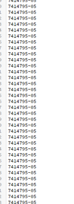

I excluded chance that something is wrong with the scanner, because in Notebook, i scan 100 times without any NOK readings. I tried different angles, distances, etc, everything works perfect in notebook.

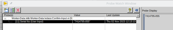

I'm scanning barcode with content : 7414795-05
On the other hand, in my block diagram, probe shows something else in NOK case: 7414795-055.
From some reason in labview is added one more character.
Seams like labview capture characters from barcode scaner to slow, so last character is repeated, or something similar.

Notepad:

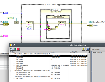

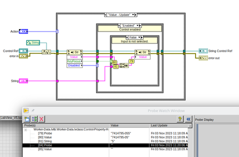

But, while i trying to debug this issue, i open plenty of different windows, and use probes.
In this case i noticed that error is not just 7414795-055. Now is 7414795-05795-05 and similar examples.
How is done in this code.

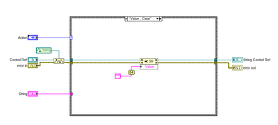

first, control is clear:
Then string is concaneted character by character.
Somehow, value reading from property node should be empty string, but obviously not, even if i clear it first.
Then if i add more probes, then i have different outcome:
I'm using actor framework, but everything is send ok to this block, and here problem occurs. At least i think.

Hi milan,
Here's your problem!
  • Why do you need to concat the string char by char?
  • Why do you need so many property nodes?
Why don't you set the string input to "don't update with each char" and "limit to single line"? Most barcode readers are able to add a CR/LF char at the end so you can easily react on "value change" of the string once you received the full barcode string!
