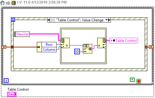

Hello Community,
I am trying to limit the string character size of an edited cell.
I understand how to limit the size of one string, but I have never done it with a table before.
Is there a way to limit the character size of the one cell being edited?
It can either return the substring or revert back to the original content in the string, then prompt the user with a message.

You'll need two events for the table.  The first event will check for Key Down.  Inside this case, use the Edit Position property node to store the location of the text edit.  In the second event (Value Change), use the stored position to get the string subset and write it back to the table.  This could be done using the In-Place element structure.  This method will allow the length to exceed your parameter while the user is typing but will truncate the data on undate of the table.
This could potentially be done with one event where any characters over the specified length just simply don't appear.  However, i haven't tried it out yet.

Aputman,
If not too difficult, would you be able to create a simple example vi using the 2 events for the table?
Message 9 of 16
(4,486 Views)
Accepted by topic author MechUnit
It was already done.  Smiley Wink
Edit: Ignore my bad coding practice for not stopping the loop properly.  It's sample code.
