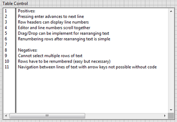

Hi aputman,
Thanks for the reply despite my poor description of the problem.
Here is a screenshot of the UI I am working on (I can't share the source code at this time) :
There are three panes: the left holds a listbox to show line numbers, the right holds an independent scrollbar, and the middle holds a string control with a visible horizontal scrollbar and no vertical scrollbar. Data can be added to the string by the user or programmatically. I need the vertical scroll position to stay synchronized for the UI to make sense.
Using mouse wheel events on the panes, value change events on the independent scrollbar, and key down events on the string, I can control almost all of the scroll behavior to my liking so that things stay in sync. But the drag/scroll behavior while selecting text does not seem to produce any event that I can use to keep things in sync -- hence, my question about preventing this behavior.
In fact, an equal (or better) solution would be finding some way to catch an event when the drag/scroll behavior when selecting text occurs.

I would recommend to look around and see if you can find a .NET text editor control with line number display.  .NET RichTextBox does not have this functionality but I'm willing to bet that someone has implemented it.
I think a classic table with visible row headers doesn't look half bad and you don't have to deal with the glitchiness of a synchronized scrolling string control.  You would need to implement some things in code but shouldn't be too bad.
You may also want to add kudos to this idea as well.
