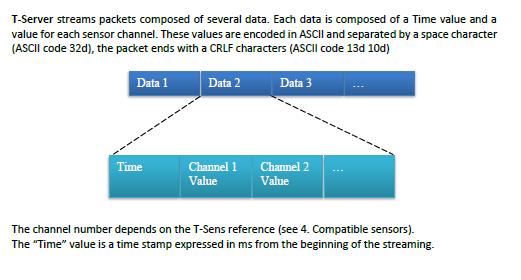

Hello everyone,since last time I posted here I was trying to get the information about the TCP etc from the manufacturer.
I got this answer from them.
1.       Open a TCP IP socket and connect to the server (note the T-Server client is created only when checking the case in the T-Server interface. Do not try to connect before it is created)
2.       Make a loop reading the data as soon as you receive a packet (T-server start streaming the data only when a record is start)
3.       For every received packet, extract the EMG data
If you are using binary format  every data is a double format (8 bytes) as describes below. Note that an EMG sensor has only one channel.
If you are using text format, the format is describe below:
So do you have any idea how I should proceed now, to get the real time EMG Signal Data displayed on a graph, and how to get that same data for a classification it in real time ?

Hey GerdW, im sending you the VI file so you can take a look if you have the time.
The data received by the tcp looks like this according to the manual
when I choose to send the data as binary
or it can look like this if I choose in the options to send the data as text
I want to get the data as a double, and the graph to display the EMG signals (channel 1 value) on the Y axis and X axis to be the time in ms. Im not sure if this is the best solution, any suggestions would be good.
