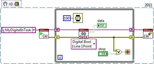

I'm having trouble using the simulated digital input feature.
I create a simulated digital input in MAX - a simulated NI PCI-6534, single channel, port 0/line 0, acquisition mode is 1 Sample (On Demand)
When I click the "run" button I see the indicator flash on and off as I would expect.
However, when I bring this task in to LbView, I can't get the indicator to flash no matter what I've tried.
No doubt I've missed some basic concept. Can anyone tell me what I'm doing wrong?
(VI attached).

You do not have N channels, you have 1 channel.  Use the appropriate DAQmx Read version.

OK, tried that, no difference

Accepted by topic author DennisW
Try starting the task explicitly before the loop (and clearing the task after the loop):

This worked for me ...

Makes sense! Works too.
