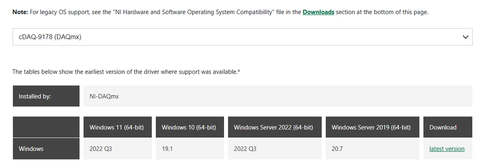

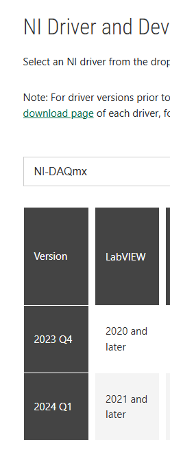

cDAQ is dependent on DAQmx driver support. So, as long as there is common DAQmx version that supports 9178 and LV24, you are good to go.
So, DAQmx 23Q4 and 24Q1 support LV2024.
9178 is supported by 22Q3 and above
So, essentially, installing the DAQmx 2024Q1 with LV2024 will work with 9178

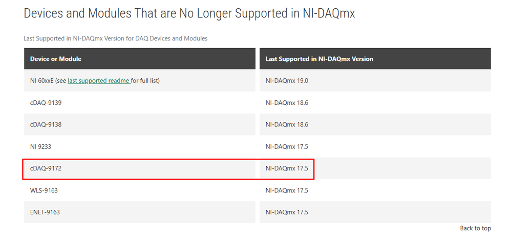

Sorry, I asked my question wrongly. I have cDAQ 9172. Can I still use it with the new versions of LabVIEW? cDAQ.jpg
(90 Views)
Unfortunately, 9172 is just too old to work with any latest software and it was last supported by DAQmx 17.5 driver
And DAQmx 17.5 is compatible with LV 2014 - 2017
