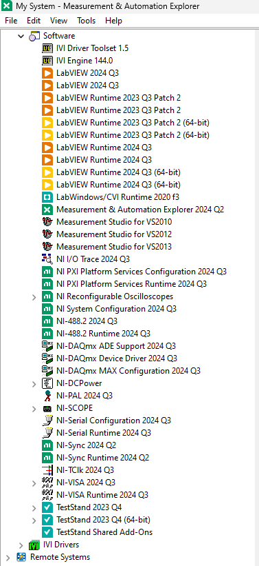

If you have NI-MAX installed on both computers, the one that works and the one that doesn't work, open the software tab of MAX and take screenshots of the installed software. Post those screenshots here. DAQmx software should be all you need to use your equipment. You may have a corrupted installation; you can try to repair it or remove everything and install.

Message 9 of 16
(458 Views)
The bottom picture in the previous post is the working computer as far as the chassis goes.
