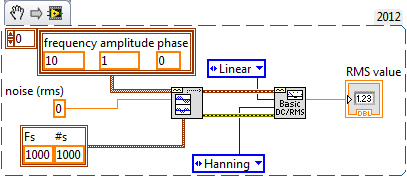

how about this?

It looks like you are already getting the RMS.  Where is your problem?
